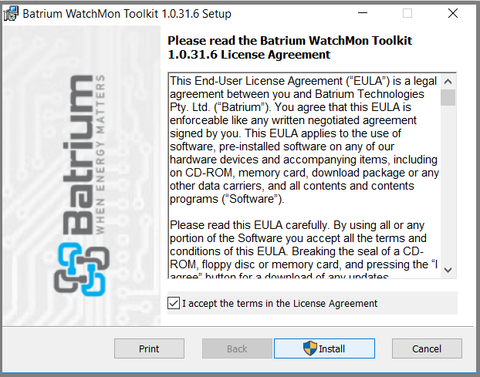

Step 1 - Download the latest software using the following link WatchMonToolkitInstaller_1.0.31.msi
Step 3 - Accept running in Admin mode.
Step 4 - Installing will run though its status of steps and complete.
Step 5 - Completion and finish of installer.
Step 6 - "WatchMon Toolkit" programs will appear in Start Menu and icon on desktop.
