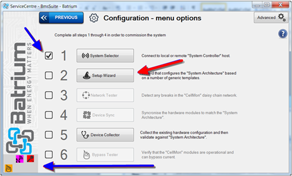

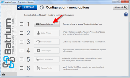

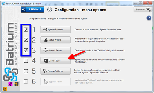

Task 1 – select system
Step 1.1 - Navigate to Configuration > "System Selector"

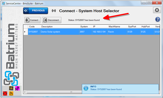

Step 1.2 - Double click relevant row for system (typically the local pc)
Step 1.3 - Verify that System has been found, once connected navigate back one step to configuration menu
NB: The status icons in bottom left should include and blinking heatbeat.

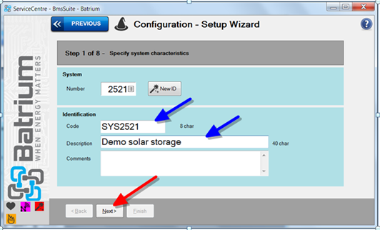

Task 2 - Setup Wizard
Step 2.1 - Navigate to Configuration > "Setup Wizard", the first task should be completed prior.
Step 2.2 - adjust names to assist with recognising the system when there are multiple. This is typically not important when only one exists, can be adjusted later in the “Advance Setup”. When completed press “Next”.

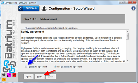

Step 2.3 - accept responsibility for the safe operation of the system

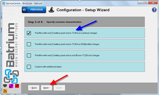

Step 2.4 - select the appropriate scenario based on the hardware configuration, in this case we will follow the typically scenario of a PacMon with canbus controlled charger

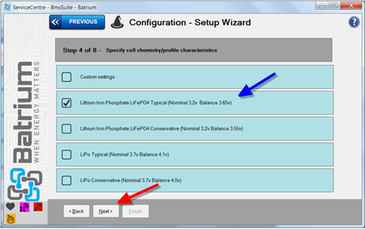

Step 2.5 - specify the cell chemistry

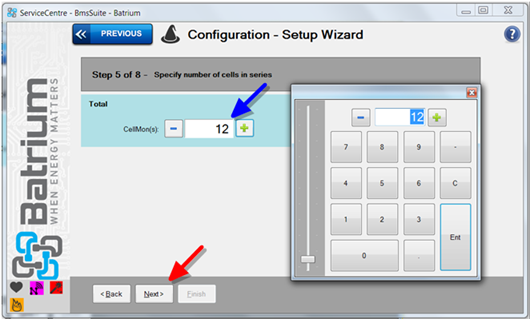

Step 2.6 - enter the number of cellmons that should be found, then press next. Click on the number to open the popup or press “plus” or “minus”, alternatively you can use the screen keypad, slider or keyboard.

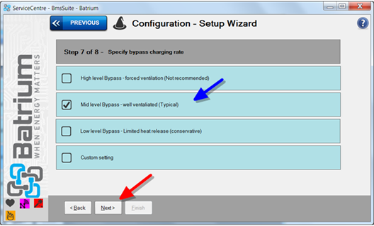

Step 2.8 - pick the well ventilated bypass option
Step 2.9 - review the parameters collected from the setup wizard, if ok press "Finish". Check that the submission was successful and navigate back

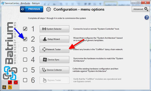

Task 3 - Network Tester
Setup 3.1 - navigate to Configuration > “Network Tester”, first two(2) tasks should be complete and ticked prior. This task will ensure that the CellMon wiring network path is ok.

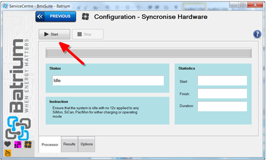

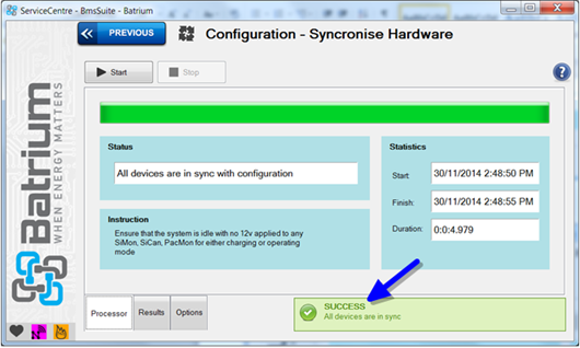

Task 4 - Device Synchronisation
Step 4.1 - navigate to Configuration > Device Sync, first three(3) tasks should be complete and ticked prior.

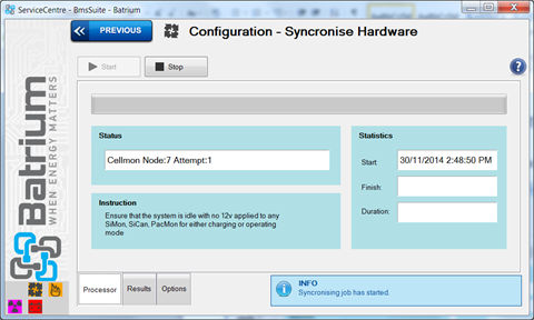

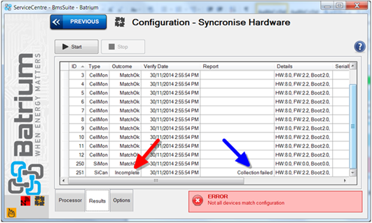

Step 4.2 - Press the “Start” button
Step 4.3 - monitor the step in progress

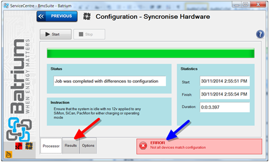

Step 4.4 - review the outcome was successful
Step 4.5 - If it fails then try again after reviewing the problem, move to the Results tab to see the problem, most times you should try again after addressing the issue reported
Step 4.6 - review the differences from the update step

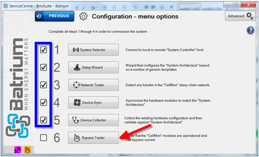

Step 6.1 - navigate to Configuration > "Bypass Tester", the first five(5) tasks need to be completed prior
Next run the bypass test to ensure that all the cellmon modules have been installed properly and able to bypass current when required at end of charge.

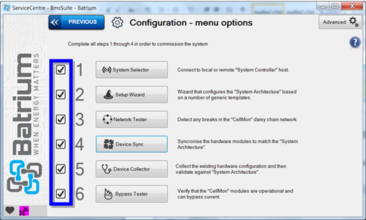

Completion
The system is ready when all six (6) tasks have been completed successfully. The hardware supervisor will operate using the provided parameters after power has been applied to the device.
